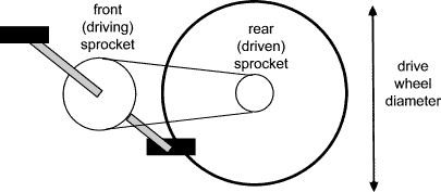

    Gear Ratios and Gear Inches
    The overall gear ratio of a bike, trike, or other type of human-powered vehicle (HPV) is determined by the size of the sprockets (gears) and the wheel diameter. The effective gear ratio of a particular sprocket combination on a bicycle is easily calculated using the following formula:
    [(# teeth on driving sprocket)/(# teeth on driven sprocket)] X wheel diameter
    If the wheel diameter is measured in inches, this formula produces a result in units of gear inches. Gear inches are often used to compare the gearing of different HPV's.
    If a bike has an internal gear hub, then the formula above is slightly modified:
    [(# teeth on driving sprocket)/(# teeth on driven sprocket)] X hub gear ratio X wheel diameter
    where the hub gear ratio is the gear ratio of the internal hub. This can be determined by watching how many times the wheel revolves for each revolution of the driven sprocket on the hub.

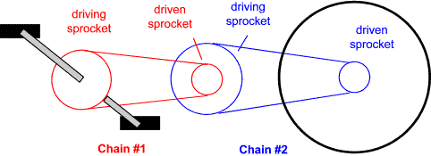

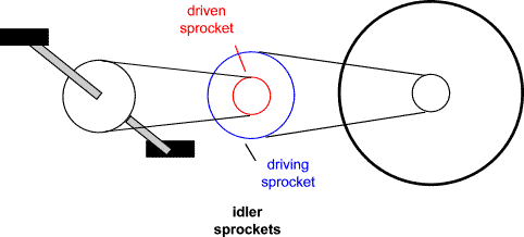

    Mid-drives or idlers
    Some trikes often have one or more additional sets of sprockets between the front and rear sprockets. These mid-drive or idler sprockets can result in a set of higher and/or lower gear ratios than is possible using just a single front and rear sprocket.
    The formula under these circumstances is similar--just break the system down into a series of chain drives and multiply the gear ratios together:
    [(# teeth on driving sprocket on chain 1)/(# teeth on driven sprocket on chain 1)]
    multiplied by
    [(# teeth on driving sprocket on chain 2)/(# teeth on driven sprocket on chain 2)]
    multiplied by
    wheel diameter
    Again, when the wheel diameter is inches, the resulting number will have units of gear inches. This makes it possible to compare the gearing between bikes and trikes regardless of whether or not they have idler sprockets.
