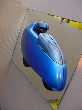

    We love eco-modders and hypermilers because their singular pursuit of superlative fuel economy often results in innovative thinking and interesting vehicles. Like, say, this Honda streamliner. Not only did Allert Jacobs’ slick DIY fairing make a pedestrian Honda Innova motorcycle downright cool, it boosted the bike’s fuel economy to 214 mpg.
    The Honda Innova is no slouch out of the box, returning 133 mpg from a 125cc engine producing a whopping 9 horsepower. But the Dutch “efficiency enthusiast,” as EcoModder calls him in its write-up, couldn’t leave well enough alone.

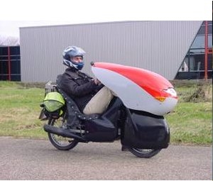

    He’s put in a lot of miles on recumbent bicycles and knows a thing or two about aerodynamics, so the first thing he did was convert the Inova to a recumbent by moving the seat waaaay down on the bike’s step-through frame and moving the footpegs. That and a simple fairing boosted the bike’s top speed from 56 mph to 69 mph. Together with taller gearing, Jacobs raised his fuel economy to 156 mpg.
    But why stop there? Jacobs spent several months designing and building the full fairing, which splits in two vertically just behind the windshield so he can get in. While it looks like you’d blow right over with a sneeze, Jacobs claims the bike is stable even in a 40-mph crosswind.
    The bike’s record is 214 mpg, and Jacobs says it averages 199. But he’s not done yet. He’s shooting for 235 mpg — which for those using the metric system is 1 liter per 100 kilometers.

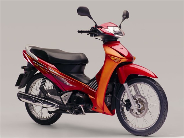

    The ideal solution for a fuel efficient motorbike would be an electrically-powered one, but Jacobs considered limited range to be problematic so he opted for the small and light engined Honda Innova 125i, which was first made available to Europeans in 2006 and was intended to replace the popular Super Cub. The Innova is already highly regarded for efficiency, Honda UK claiming it gives: "a robust 46 miles of operation on a single liter of fuel (measured at an operating urban speed of 33mph)".
    Filling its 3.7 liter fuel tank got Jacobs around 140 miles to the gallon (mpg) during the initial run in period required for a new vehicle. When he started to increase throttle activity somewhat, the scooter still offered between 107 and 122mpg. Inspired by the work of the likes of Vetter, Jacobs decided to aim for 235mpg fuel efficiency for his creation.

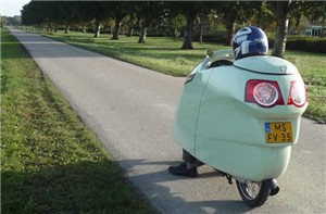

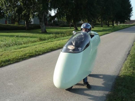

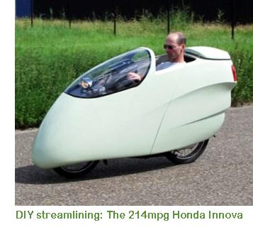

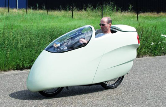

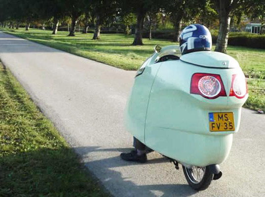

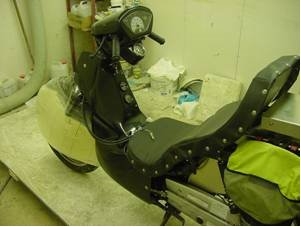

    In the Winter of 2007 Jacobs started his project by stripping away the Innova's body work and seating. He then installed footrests above the front wheel to cater for a recumbent riding position, threw in some seating and attached a nosecone. An early evaluation showed that even these modest modifications had increased the bike's top speed and fuel efficiency but there was still much more to be done.

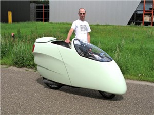

    As a result of instability issues, he was forced enclose the front wheel within the streamlining casing instead of underneath the nosecone and modify the riding position so that his feet moved down to rest at each side of the wheel when in motion. The latter half of 2008 was spent taking the design suggestions offered by a 1:5 scale model and creating a full size template from PU foam.
    2009 dawned and with it the creation of the mould for the final streamlined casing. Modifications were made to the steering and the exhaust was lowered so that it sat outside of the casing. Getting in and out of the casing was made possible by slicing it down the middle and attaching the front end to a rail which extended it forward by 18 inches. Rubber cones and trips ensured a snug fit when in cruising position and an open bottom design catered for stable ground footing when at rest. The lights were also wired up and tested.
    Hit the road, Jack
    With everything in place and working it was time for the all important road test. Jacobs climbed into the 319 pound vehicle (88 pounds heavier than the original scooter) and set off for a 160 mile stretch of open road. His creation managed to achieve an amazing 214mpg at around 55mph with good conditions and only a 25mph wind.
