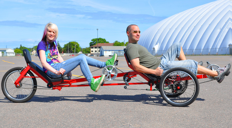

    If you have been eyeing up those expensive imported tandem trikes, but think $8,000 is a bit too steep of a price tag, then get out your tools and build it yourself! For thousands of dollars less than the price of a basic tadpole trike, you can create your very own tandem trike that will rival many of the factory built machines available.​
    That's a CLEAN looking trike, with nice simple lines! For sure the best DIY tandem I've ever seen. :biggrin9:
